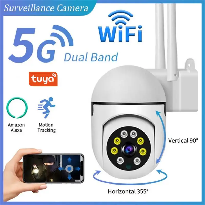

Ola, alguem sabe me dizer se essa camera funciona no HA?
https://pt.aliexpress.com/item/4001196688301.html?aff_fcid=33628342678b4b58bcf6584e7b89faa3-1679527547209-04684-_DFtlNvb&tt=CPS_NORMAL&aff_fsk=_DFtlNvb&aff_platform=shareComponent-detail&sk=_DFtlNvb&aff_trace_key=33628342678b4b58bcf6584e7b89faa3-1679527547209-04684-_DFtlNvb&terminal_id=5285be3c09d34bdf9018f61b7f301a34&afSmartRedirect=y
