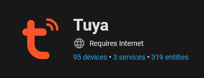

### The problem
Tuya integration freezes from time to time. Couldn't find a pat…tern. It might take one minute, ten or hours.

I am running home assistant inside a Virtualbox vm. Host is Windows 11 23H2 22631.5624 fully patched, VirtualBox 7.1.12r169651. Usually, reloading the integration solves the problem for another random period of time.
