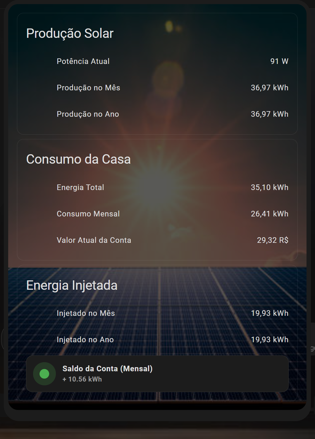

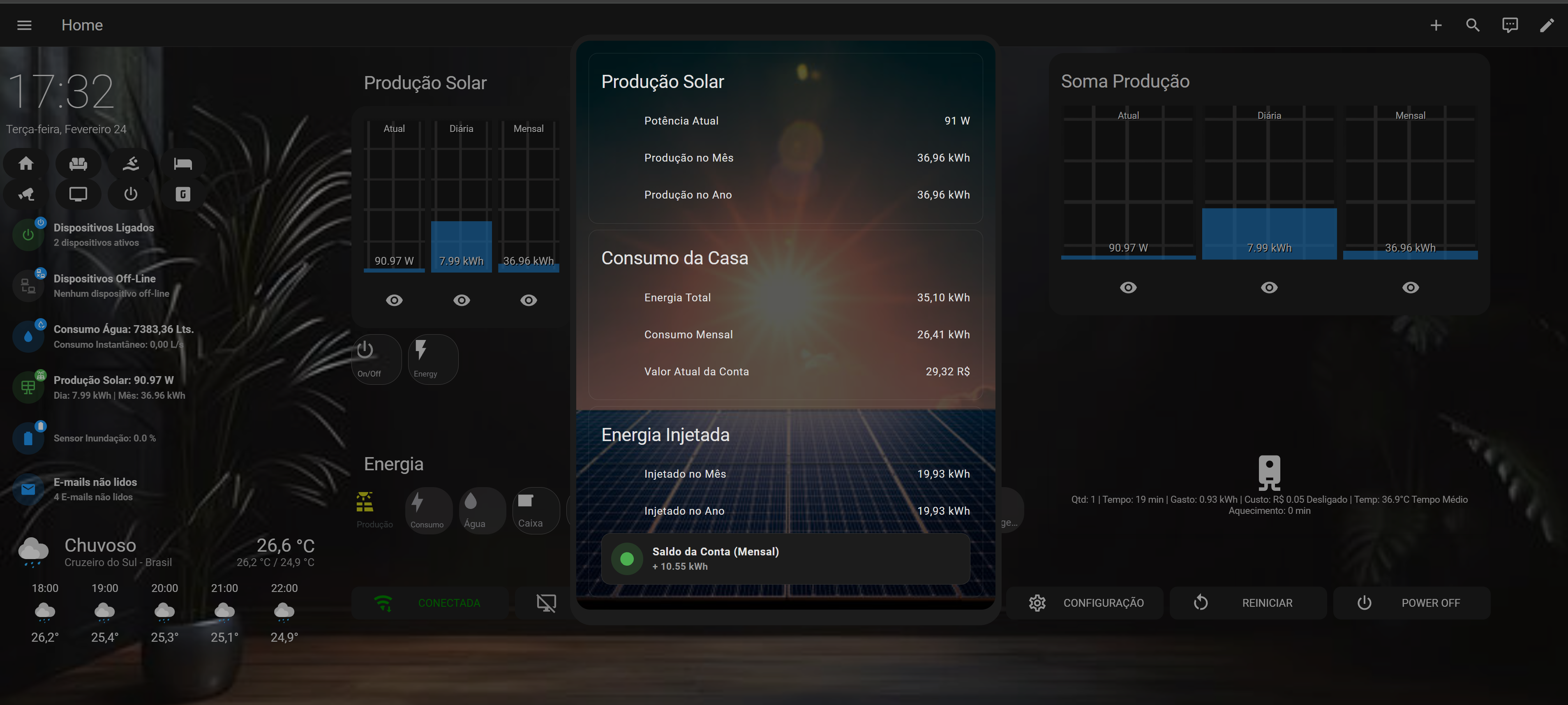

:camera_with_flash: Preview da Dashboard
Dashboard Principal
:file_folder: :three: Card com Popup (cards/card_popup.yaml)
type: custom:mushroom-template-card
primary: >
  Produção Solar: {{ states("sensor.sonoff_1000916c58_power") | float(0) |
  round(2) }} W
secondary: >
  Dia: {{ states("sensor.sonoff_1000916c58_energy") | float(0) | round(2) }} kWh
  | Mês: {{ states("sensor.producao_solar_mensal") | float(0) | round(2) }} kWh
icon: mdi:solar-panel
icon_color: green
badge_icon: mdi:solar-power-variant-outline
badge_color: green
tap_action:
  action: fire-dom-event
  browser_mod:
    service: browser_mod.sequence
      sequence:
        - service: script.pc_click
        - service: browser_mod.popup
            content:
              type: custom:mod-card
              style: |
                ha-card {
                  background: linear-gradient(
                    rgba(0,0,0,0.65),
                    rgba(0,0,0,0.65)
                  ), url("/local/cardpainel2.jpg") center/cover no-repeat;
                  background-size: cover;
                  background-position: center;
                  border-radius: 18px;
                  padding: 16px;
                  box-shadow: 0 8px 30px rgba(0,0,0,0.4);
              card:
                type: vertical-stack
                cards:
                  - type: entities
                    title: Produção Solar
                    card_mod:
                      style: |
                        ha-card {
                          background: transparent;
                          box-shadow: none;
                    entities:
                      - entity: sensor.sonoff_1000916c58_power
                        icon: none
                      - entity: sensor.producao_solar_mensal
                        name: Produção no Mês
                        icon: none
                      - entity: sensor.producao_solar_anual
                        name: Produção no Ano
                        icon: none
                  - type: entities
                    title: Consumo da Casa
                    card_mod:
                      style: |
                        ha-card {
                          box-shadow: none;
                    entities:
                      - entity: sensor.consumo_atual_rede_w
                        icon: none
                      - entity: sensor.breaker_energia_total_2

:file_folder: :four: Card Simples (cards/card_simples.yaml)
style: |
  ha-card {
      rgba(0,0,0,0.65),
      rgba(0,0,0,0.65)
    padding: 16px;
card:
  cards:
    - type: entities
      card_mod:
        style: |
          ha-card {
            box-shadow: none;
      entities:
    - type: entities
      card_mod:
        style: |
          ha-card {
            box-shadow: none;
      entities:
        - entity: sensor.consumo_energia_mensal
        - entity: sensor.valor_conta_mensal_real
          name: Valor Atual da Conta
    - type: entities
      title: Energia Injetada
      card_mod:
        style: |
          ha-card {
            box-shadow: none;
      entities:
        - entity: sensor.injecao_energia_mensal
          name: Injetado no Mês
        - entity: sensor.energia_injetada_anual
          name: Injetado no Ano
        - type: custom:mushroom-template-card
          entity: sensor.saldo_mensal_kwh
          primary: Saldo da Conta (Mensal)
          secondary: >
            {% set v = states('sensor.saldo_mensal_kwh')|float %} {% if v >= 0
              + {{ v | round(2) }} kWh
            {% else %}
              - {{ (v | abs) | round(2) }} kWh
          icon: mdi:circle
          icon_color: |
            {% if states('sensor.saldo_mensal_kwh')|float >= 0 %}
              green
            {% else %}
              red
          layout: horizontal
          fill_container: true
