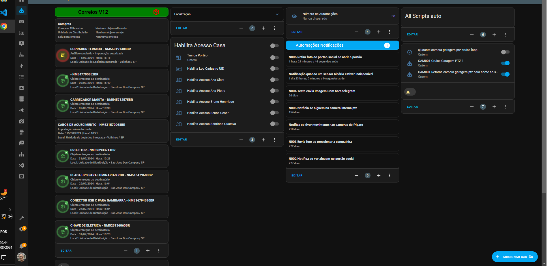

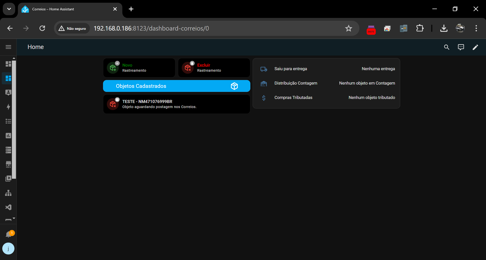

Card 1:
type: vertical-stack
cards:
  - type: horizontal-stack
    cards:
      - type: custom:mushroom-template-card
        primary: Novo
        badge_icon: mdi:plus
        secondary: Rastreamento
        icon: mdi:package-variant-closed-plus
        fill_container: true
        layout: horizontal
        icon_color: green
        tap_action:
          action: fire-dom-event
          browser_mod:
            service: browser_mod.popup
              title: Adicionar Rastreio
              right_button: Salvar
              right_button_action:
                service: button.press
                  entity_id: button.correios_salvar
              content:
                type: entities
                entities:
                  - entity: select.correios_notificacao
                    name: Deseja receber notificações?
                    icon: mdi:bell-ring
                  - entity: text.correios_rastreio
                    name: Qual o Código de Rastreamento?
                  - entity: text.correios_nome_objeto
                    name: Qual nome do Objeto?
                    icon: mdi:form-textbox
        card_mod:
          style: |
            ha-card {
              --ha-card-background: black;
              --card-primary-color: green
        primary: Excluir
        icon: mdi:package-variant-closed-remove
        icon_color: red
        text_color: red
        badge_icon: mdi:delete
        layout: horizontal
        multiline_secondary: false
        tap_action:
          browser_mod:
              title: Excluir Rastreio
              right_button: Excluir
                  entity_id: button.correios_excluir
              content:
                type: entities
                entities:
                  - entity: select.rastreio
                card_mod:
                  style: |
                    ha-card {
                      height: 200px !important;
        card_mod:
          style: |
            ha-card {
              --card-primary-color: red
  - type: custom:button-card
    layout: icon_name
    name: Objetos Cadastrados
    styles:
      grid:
        - grid-template-areas: '"n i"'
        - grid-template-columns: 1fr 20%
      icon:
        - align-self: end
        - color: var(--text-primary-color)
        - height: 35px
      card:
        - padding: 4px
        - height: 40px
        - background: var(--primary-color)
      name:
        - justify-self: start
        - padding-left: 10%
        - font-weight: 400
        - font-size: 18px
  - type: custom:auto-entities
    card:
      type: grid
      columns: 1
      square: false
    card_param: cards
    show_empty: false
    filter:
      include:
        - entity_id: sensor.correios_*
          options:
            card_mod:
              style: |
                ha-card {
                  color: white;
            entity: this.entity_id
            primary: '{{ state_attr(''this.entity_id'', ''friendly_name'') }}'
            secondary: >-
              {% if states['this.entity_id'].state == '[]' %} Objeto aguardando
              postagem nos Correios.   {% elif states['this.entity_id'].state ==
              "[{}]" %}Sincronizando com sistema dos correios  {% else
              %}              {{ state_attr('this.entity_id', 'status')|join()
              {{ state_attr('this.entity_id', 'data')|join() }}
              {{ state_attr('this.entity_id', 'local')|join() }}
              {{ state_attr('this.entity_id', 'destino')|join() }}
            icon: >-
              {% if states['this.entity_id'].state == "['Objeto entregue ao
              destinatário']" %}
                mdi:package-variant-closed-check
              {% elif states['this.entity_id'].state == "['Objeto entregue ao
              remetente']" %}
              {% elif states['this.entity_id'].state == "['Objeto postado']" %}
                mdi:store-plus
              {% elif states['this.entity_id'].state == "[]" %}
              {% elif states['this.entity_id'].state == "[{}]" %}
                mdi:refresh
              {% elif states['this.entity_id'].state == "['Objeto saiu para
              entrega ao destinatário']" %}
                mdi:human-dolly
              {% elif states['this.entity_id'].state == "['Objeto está em rota
              de entrega']" %}
                mdi:human-dolly
              {% elif states['this.entity_id'].state == "['Objeto recebido pelos
              Correios do Brasil']" %}
                mdi:flag-variant
              {% elif states['this.entity_id'].state == "['Objeto em trânsito -
              por favor aguarde']" %}
                mdi:truck
              transferência - por favor aguarde']" %}
                mdi:truck
              {% elif states['this.entity_id'].state == "['Informações
              eletrônicas enviadas para análise da autoridade aduaneira']" %}
                mdi:file-document-outline
              {% elif states['this.entity_id'].state == "['Análise concluída -
              importação autorizada']" %}
              {% elif states['this.entity_id'].state == "['Fiscalização
              aduaneira concluída - aguardando pagamento']" %}
                mdi:currency-usd
              {% else %}
            icon_color: >-
              destinatário']" %}
                green
                red
                red
                orange
              de entrega']" %}
                orange
              remetente']" %}
                red
                blue
                blue
                red
              {% else %}
                yellow
            multiline_secondary: true
            badge_icon: >-
              destinatário']" %}
                mdi:check-bold
                mdi:share
              remetente']" %}
                mdi:share
                mdi:alert-box
                mdi:share
              de entrega']" %}
                mdi:share
                mdi:map-marker
                mdi:share
                mdi:share
                mdi:share
                mdi:share
                mdi:currency-usd
              {% else %}
                mdi:map-marker
            badge_color: >-
              destinatário']" %}
                green
              remetente']" %}
                red
              {% elif states['this.entity_id'].state != "['Objeto entregue ao
              destinatário']" %}
                grey
            tap_action:
              action: more-info
            order_by:
              last_changed: asc
    sort:
      method: last_changed
      count: 10
      reverse: true`Texto pré-formatado`
Card 2:
type: entities
entities:
  - entity: sensor.saiu_para_entrega
  - entity: sensor.distribuicao_contagem
  - entity: sensor.compras_tributadas

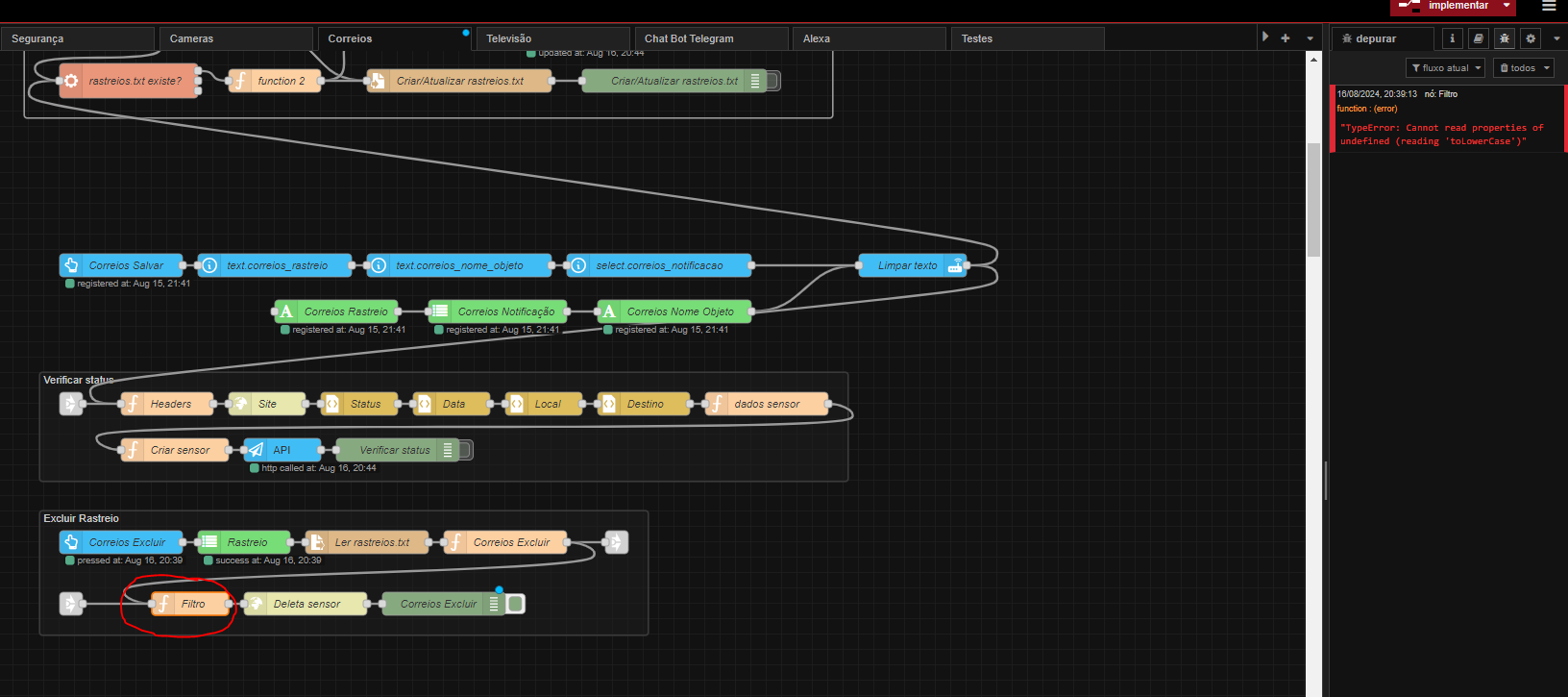

cara pode me ajudar com o no filtro na parte de excluir ?, as ecomendas não estão saindo automaticamente, e ao tentar excluir ele da erro no nó filtro TypeError: Cannot read properties of undefined (reading ‘toLowerCase’)
Card HA
Nod Red
Realmente tinha parado de funcionar, teve atualização do palette home-assistant-websocket e o nó de pegar entidades estava com um bug. Mas o pessoal já corrigiu, atualiza para essa versão:
node-red-contrib-home-assistant-websocket - 0.67.2
Aqui voltou ao normal depois dessa atualização. Não esquece que você precisa reiniciar o add-on depois de atualizar para dar certo

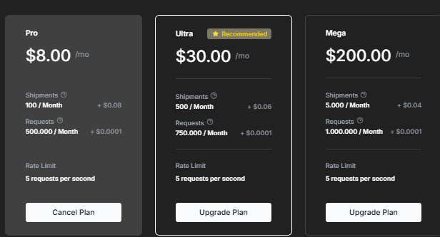

Já tenho solução e já estou usando, pega rastreio de todos os sites e transportadora. (shopee, aliexpress, shien, correios, amazon… Praticamente tudo)
Porém essa não irei postar, a API é paga e sem retorno financeiro se torna caro postar free para todos. Caso encontre uma solução gratuita eu posto
Qual o valor da API?
entendi, mais esse valor da api eu possso usar por ano, dai eu faço uma para mim, me tornei depende do seu codigo, me viciou e agora estou igual noia atras de fazer funcionar novamente
